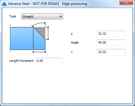

You can use the parameters on this tab to modify the chamfer size.
| X | Defines the length of the chamfer along the first selected edge of the plate. |
| Y | Defines the length of the chamfer along the next edge of the plate. |
| Length Increment | Defines the increment (grid jump) for modifying the width and the length of the corner processing by grip points. |

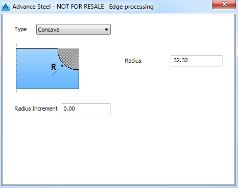

You can use the parameters on this tab to modify the fillet shape. The fillet shape is modified by setting the radius value.
| Radius | Defines the radius of the convex or concave fillet. |
| Radius increment | Defines the increment (grid jump) for modifying the radius length by grip points. |
