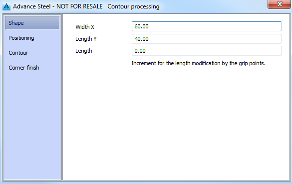

Use the parameters on this tab to modify the rectangular contour size.
| Width X | Defines the width of the rectangular processing. |
| Length Y | Defines the length of the rectangular processing. |
| Length | Defines the length increment (grid jump) when modifying the contour length using the grips. |
