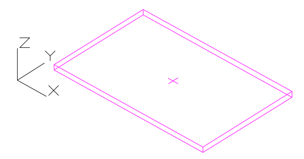

Learn the different ways to create a rectangular plate.
The rectangular plates of a default size are placed in the X/Y plane of the current coordinate system. The plate thickness direction is in the positive Z direction. You can control the Advance default plate thickness, using the Management Tools application.
Access the command
On the Objects tab
Plates panel, click
(Rectangular plate, center).
Command line: _AstM4CreateRect1DigPlate
Plates panel, click
The rectangular plates are placed in the X/Y plane of the current coordinate system. The plate thickness direction is in the positive Z direction. You can control the Advance default plate thickness, using the Management Tools application.

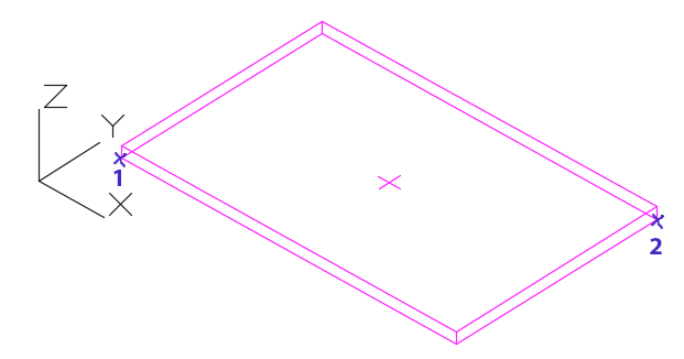

Access the command
On the Objects tab
Plates panel, click
(Rectangular plate, 2 points).
Command line: _AstM4CreateRect2DigPlate
Plates panel, click
