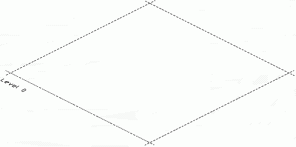

When visible in 3D, work planes are represented by rectangles with a name. The size of the rectangle depends on the current zoom. Displaying the work plane helps understanding the active work plane in a 3D view and it is useful for viewing the work plane location when attaching elements.
