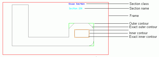

Create section components
The section components are drawn with AutoCAD elements. Next, you need to create two texts with the name of the section (e.g. IPE 200) and the name of the section class (e.g. IPE). For each user section component you must set a corresponding layer. You can do this by using the Change current layer flyout.
The user section components
The definition frame must include the whole section contour with all its information and is required to create the section.
The outer contour defines the standard representation of the section in the model and should not include too many details to avoid a complex representation in the model.
The exact outer contour
The exact outer contour defines the exact outline of the section that is used for clash checking, drawings and weight calculation.
The outer contours must be created using a closed polyline, a circle, or a rectangle.
Section inner exact and simple contour
Closed polylines, circles and rectangle are allowed as elements. The inner contour is necessary, for example, to create hollow sections.
The exact inner contour defines the exact outline of the hollow section that is used for clash checking, drawings and weight calculation.
Section name
The text for the section name.
Section class
The text for the section class name that will appear on the Section&Material tab in the Advance properties dialog box.
