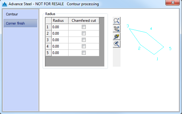

Use the table parameters to change the shape of each corner of the polygonal contour.
| Radius | Defines the radius of the corner finish. |
| Chamfered cut | If enabled, creates a chamfered corner. Otherwise a filleted corner is created. |
| Preview area | Displays a preview of the polygonal contour. |
Zoom real time |
The cursor changes to
Panoramic |
Moves the object in the preview area. |
3D orbit |
Modifies the 3D objects view in the preview area. |
Initial view |
Restores the initial magnification and position |
