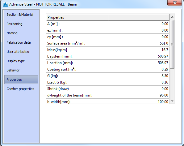

This tab of the beam properties dialog box, lists the beam geometric properties and the section geometric values.
| Properties | Description |
| A [m2] | Cross section area |
| ez[mm] | Center of gravity distance |
| ey[mm] | Center of gravity distance |
| Surface area [mm2/m] | Coating surface per meter |
| Mass [kg/m] | Weight per meter |
| L system [mm] | System line length in mm |
| L section [mm] | Physical beam length in mm |
| Coating surf. [m2] | Coating surface in mm2 |
| G [kg] | Beam total weight (the beam contour processings are not taken into account). |
| Exact G [kg] | Beam exact weight |
| Shrink (draw) | |
| d-height of the beam [mm] | Beam height in mm |
| b-width [mm] | Beam height in mm |
| tw-web thickness [mm] | Beam web thickness in mm |
| tf-flange thickness [mm] | Flange thickness in mm |
| R-Inner radius [mm] | Radius in mm |
| k [mm] | c-dimension (t+r) in mm |
| g1-bolt gauges [mm] | Distance to gauge lines in mm |
| g2-bolt gauges [mm] | |
| g3-bolt gauges [mm] | |
| T=d-2k [mm] | T distance, in mm |
