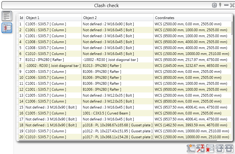

Displays the list of collisions in beams, plates, and bolts for an entire model or a selection set.
The collisions are numbered with continuous index numbers. For each collision, the involved elements and the coordinates referring to the world coordinate system are listed.
For each found collision, the following information is displayed:

Double-clicking a line corresponding to a collision zooms directly to the collision solid.
| Icon | Description |
(Search marked objects)
Displays a red arrow that shows the location of the collision solids. |
(Clear marked objects)
Turns off collision solids and the marking arrow. |
(Ignore object)
Ignores the selected collision. The collision is removed from the list. |
(Reset ignored objects)
Displays the list of all collisions again. |
