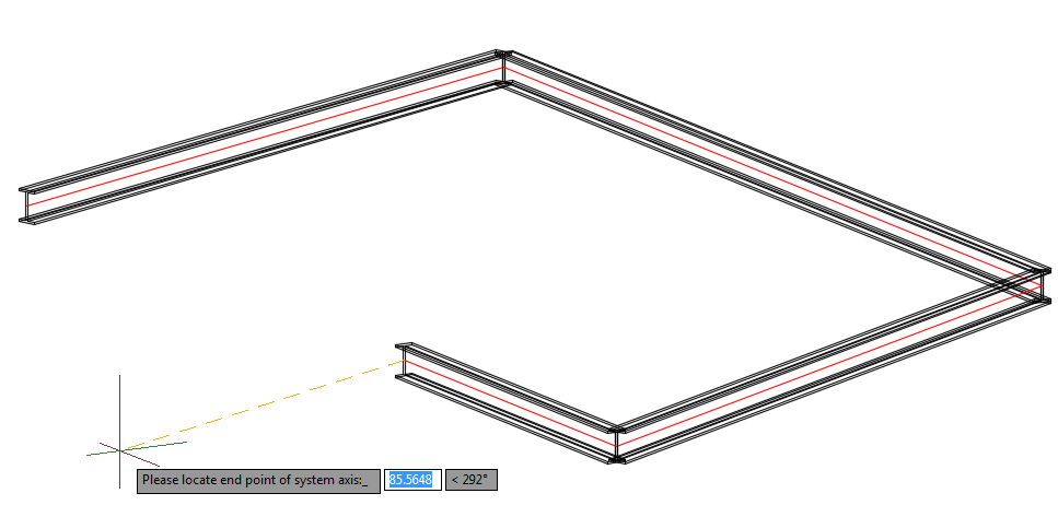

The Continuous Beam Command
The Continuous Beam command allows you to create linked beams continuously. The command stops if you press the Esc or Enter keys or if you click the right button on your mouse.

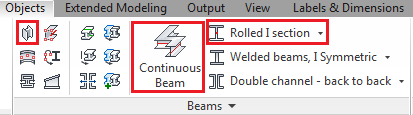

All these commands are located on the Objects tab
Beams panel:
