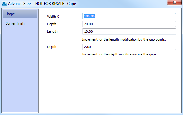

Use the parameters on this tab to modify the cope size.
| Width X |
Defines the cope width in the beam direction.
| Depth |
Defines the cope depth in the beam height direction.
| Length | Defines the length increment (grid jump) when modifying the cope length using the grips. |
| Depth | Defines the increment for the distance from axis modifications using the grips. |
