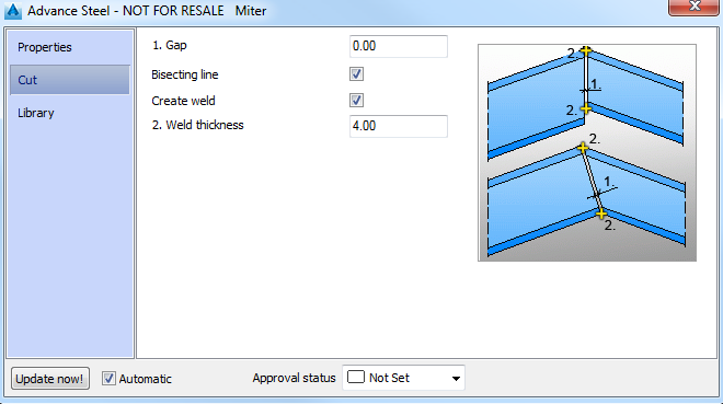

On this tab of the properties dialog box, you can set the clearance between the beams.
Gap |
Defines the construction gab between the beams. |
Bisecting line |
When selected, the intersection of the beams is created at the bisecting line. |
Create weld |
Creates a weld between the two beams. |
2. Weld thickness |
Defines the weld thickness. |
