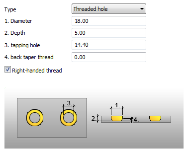

| Right-handed thread check box | |

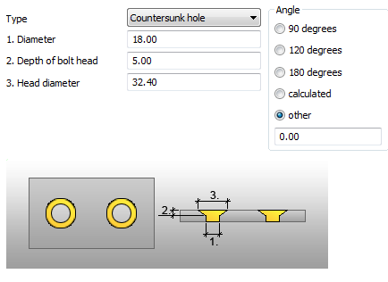

| Countersink hole | |
| Diameter | Defines the hole nominal diameter. |
| Depth | Defines the depth of the hole. |
| Alpha |

| Threaded hole | |
| Countersunk hole | |
