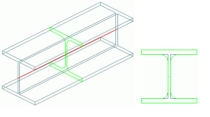

For more clarity in the graphical representation, the beams are modeled with a simplified cross section contour.
The section contour is reduced to a very simple shape that just meets the requirements of the profile functionality. This representation only reflects the functional aspects.
The exact cross section displays all contour details (including radii).

Display the beam exact cross section
Beams panel, click
(Insert beam cross section).
