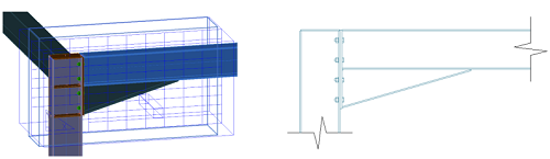

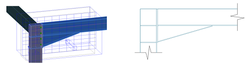

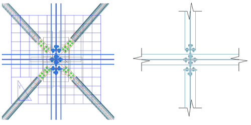

Example
In the case of a camera containing a node where several beams and braces intersect, you can obtain a camera detail drawing showing only the beams and their respective connections:
