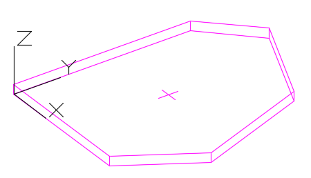

Learn the different methods to create polygonal plates.
The polygon plates are placed in the X/Y plane of the current coordinate system. The plate thickness direction is in the positive Z direction. You can control the Advance default plate thickness, using the Management Tools application.
