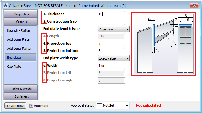

The other tabs contain graphic explanations of the available parameters - the numbers in the sketches correspond to the information entry boxes.

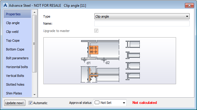

Each connection dialog box has:
| Option | Description |
| Type | Lists the available connection types. The graphic representation in the dialog box changes according to the selected type. |
| Name | Displays the name of the connection group. The name can be set only for the master connection of a group. |
| Upgrade to master check box | This option is available only for the slave connections within a group. If checked, the current connection becomes the master of the connection group so that any of the properties from the connection dialog box can be modified. |
