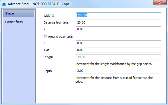

You can use the parameters on this tab to modify the cope size.
| Width X |
Defines the cope width.
| Distance from axis |
Defines the cope corner distance to the beam axis.
| X | Defines the rotation angle around the X-axis of the coordinate system. |
| Around beam axis | |
| Z | Defines the rotation angle around the Z-axis of the coordinate system. |
| Axis | Defines the rotation angle around the cope axis. |
| Length | Defines the length increment (grid jump) when modifying the cope length using the grips. |
| Depth | Defines the increment (grid jump) when modifying the distance from the axis using the grips. |
