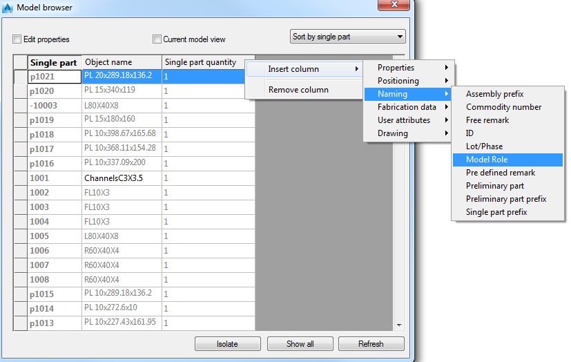

This dialog box displays the list of elements of a model and their properties as a table. The set of displayed properties can be customized by adding or removing columns.
| Option | Description |
| Edit properties check box | Controls whether the element properties can be modified or not. Only some properties can be modified. For example, the properties of the elements that are part of a connection cannot be modified in the Model Browser. |
| Current model view check box | Displays the list of elements in the current model view. |
| Drop-down list | Allows displaying only the single parts or only the assemblies. |
| Isolate button | The drawing area displays only the elements selected in the list. |
| Show all button | Displays all elements of the model in the drawing area. |
| Refresh button | Updates the model browser content according to the latest changes in the model. |
| Properties list | Lists the elements of the model sorted by the single part or assemblies, according to the selection. Their properties are displayed in the columns. The set of displayed columns can be selected from the table context menu. The properties are modified in the Model Browser. When Edit properties is enabled some of the properties for the selected lines of the Model Browser can be changed. |
