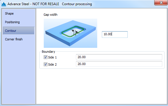

Use the parameters on this tab to adjust the contour.

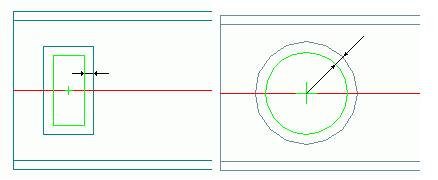

| Gap width |
Defines the distance between the processing object (green contour) and the contour. It modifies the size of the rectangular contour cut. ![]() |

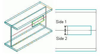

| Boundary |
Allows setting the contour top and bottom boundaries (in the Z axis direction). ![]() |
| Side 1 | Side 2 |
| Defines the top boundary in the positive direction of the Z axis of the coordinate system at creation time. | Defines the top boundary in the negative direction of the Z axis of the coordinate system at creation time. |
