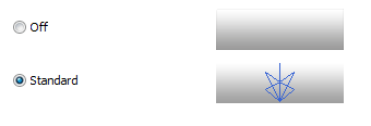

Off
Hides all selected level symbols.
Standard
Displays the level symbols in the Standard representation.
