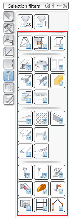

Selection filters tool palette:

These tools allow you to filter a set of objects of a specific type (beams, plates, gratings, etc) from the entire model or from a selection. You select the object type from the selection that you want to filter using the Selection filters tool palette.
To access the command
Selection filters tool palette: Select the desired element type.
Command line: _AstM4SelectObjectByName [type of object]
To filter an object selection
