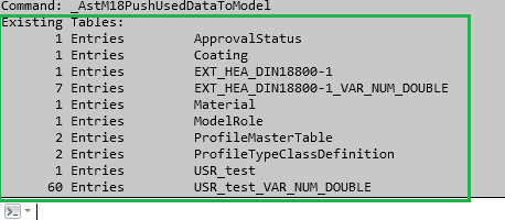

To store used data in the current DWG file:
Tools panel, click
(Store used data).
Following this workflow, you can share the model with other users and all the beam information used inside the model will be automatically available.
