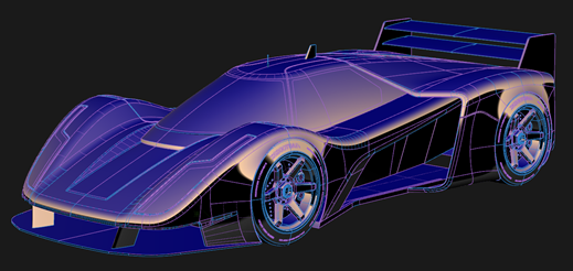

Diagnostic Shading
Opens the Diagnostic Shading, window provides access to various shade the model using various modes. Use the diagnostic shaders to view and evaluate your surfaces.
The various shading modes provide different diagnostic information about surfaces. Clicking a diagnostic shader icon in the window applies the shader to the selected geometry.

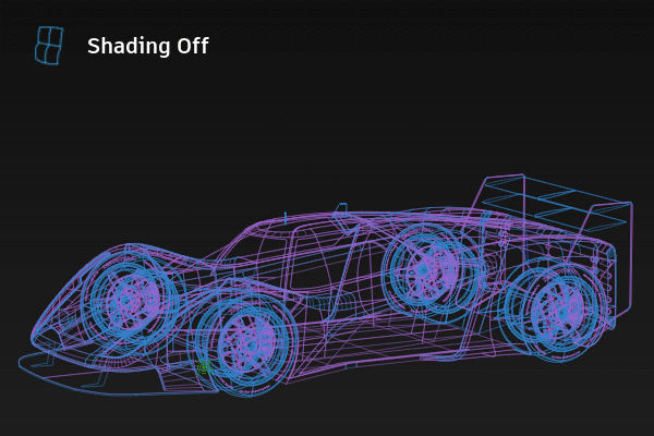

Shading Off
The wireframe model appears with no shading. This icon clears the wire model of its current shading. No options are available with this shading mode.

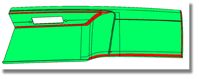

Multi Color
Shades all the picked surfaces with a single color. Useful for detecting bumps, dents, or other surface irregularities.

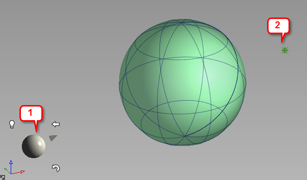

By default, Diagnostic Shading uses a point light located at the eye position of the camera. You cannot see or pick this light as an object, but you can change its parameters in the Shader Settings.
The Multi Color icon shades all the picked surfaces with a single color that you can choose. Use this shading mode to see how your model looks as a finished product, and detect any bumps, dents or other surface irregularities. You can control the shading qualities with the Light options.

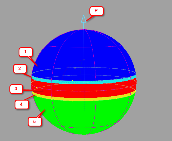

Random Color
Shades the surface with random colors. Adjacent surfaces display with different colors, making it easier to see the patch structure, and how the patches align.
The Random color mode shades the surfaces with random colors. As a result, adjacent surfaces show up in different colors, making it easier to see the patch structure, and how the patches align with one another.

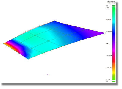

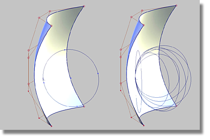

Curvature Evaluation
Color-codes the curvature of the selected surfaces. Useful for identifying where the curvature changes either abruptly or subtly and finding potential flaws.
This mode includes nine ways to view curvature. The tools color-code the curvature of your surfaces. Color-coding curvature is useful for evaluating the curvature of your model. You can see where the curvature changes either abruptly or subtly. You can also find potential flaws.

Curvature Evaluation Type
(applies to the Curvature Evaluation shader) The Curvature Evaluation Type settings listed in the image calculate the curvature of surfaces on each point. This calculation measures the diameter of a circle that touches the surface at each point. Points that have a circle with the same diameter are displayed with the same color. Each point can have several circles. The Curvature Evaluation Type settings specify which circles are used for the calculation.
Note: This option is not available for all Alias products.
Crv V, Crv U
Display the curvature in the surface’s V or U parameter direction at each point.
Crv Z, Crv Y, Crv X –
Display the curvature in the Z, Y, or X direction at each point.
Mean
Use the average of the two principal curvatures to approximate the average curvature through each point.
Gaussian
Use the product of the two principal curvatures.
Princ. Min
Use the minimum curvature values (that is, the curvature of the flattest curves that pass through each point).
Princ. Max
Use the maximum curvature values (that is, the curvature of the steepest curves that pass through each point). In the image below, the surfaces, or areas of surfaces that fall below the defined radius limit are highlighted in red through the Princ. Max setting.
Curvature Color Scale
(applies to the Curvature Evaluation shader) Scales the radius ramp to show finer details of curvature variation.
Note:This option is not available when Curvature Evaluation Type is set to Princ. Min or Princ. Max and the Min. Radius Limit or Max. Radius Limit are turned on.

When this option is checked on (default) the light source for the shading comes from the camera like a headlight, so that the highlights move over the model as you tumble around it.
Checking off this option un-links the light source from the camera and locks it to its current position, so the highlights remain stationary as you tumble. It also displays two sliders and a manipulator that let you rotate the light around the model.
Note: The center of rotation is calculated at the moment Link Light to Camera is checked off. It corresponds to the tumble center used when tumbling with Alt + Shift + left mouse button, with Tumble Center set to World Point in View > World Move Camera > Tumble. Setting a point-of-interest (POI) on the geometry or doing a View > Look At modifies the tumble center, hence the center of rotation.

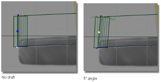

Draft Angle
Some manufacturing processes, like injection molding, need you to design molds. A section of a mold only moves in a certain direction during removal. This direction is the pull vector.
  • The mold parts are pulled away from the object in a straight line, the pull vector.
  • If the sides of the mold are too steep, the object cannot leave the mold. As well, the object cannot leave the mold if the mold undercuts itself.
  • The minimum allowable angle between the sides of the mold and the pull vector is the draft angle.
  • If part of a surface has an angle less than the draft angle, it is said to be out-of-draft.
  • Draft lines are the boundaries between in-draft and out-of-draft regions.
  • The parting line sits at a draft angle of zero degrees, and corresponds to the location where the mold separates.
Angle-to-pull is the angle between the surface tangent plane at a surface point and the pull vector. When the angle-to-pull is 0 degrees, the pull vector is parallel to the surface tangent plane at that point. When the angle-to-pull is 90 degrees, the pull vector lies normal to the surface.
Most manufacturing processes require that the angle-to-pull for a molded surface be greater than some angle, for example 1 degree, or else the molded part will not separate from the mold. This angle is the draft angle.
When the angle-to-pull is less than the draft angle, the surface point is out-of-draft. When the angle-to-pull is more than the draft angle, the surface point is in-draft.
The Draft Angle shading mode offers the ability to evaluate in-draft and out-of-draft regions along both directions of the pull vector, since a mold often separates in both directions. Positive and negative in-draft and out-of-draft regions of the surface, as well as tolerance regions are shaded different colors. Tolerance regions are "grain wash" zones that forms part of the out-of-draft regions.
In the pictures above, the draft surface is angled in to the pull direction by 5 degrees. This angle allows the model to be withdrawn from the injection mold.
Tip: The Draft Angle evaluation works best when all selected surfaces are oriented the same way, either facing inwards, or outwards.
In-draft points are shaded blue or green, while out-of-draft points are shaded red. You can also display tolerance regions in cyan and yellow through the Pos Tolerance and Neg Tolerance number fields.
Output from Draft Angle diagnostic shading showing the different shaded regions.
  • p - Pull direction
  • 1 - Positive in-draft region
  • 2 - Positive tolerance region
  • 3 - Out-of-draft region
  • 4 - Negative tolerance region
  • 5 - Negative in-draft region

Move the light around the diagnostic shaded objects
The following diagnostic shaders let you unlink the light from the camera position:
  • Multi-Color
  • Random Color
  • Horizontal/Vertical
  • User Defined Texture.
When you choose one of these shading modes in the Diagnostic Shading window, and clear the Link Light to Camera option, a white sphere manipulator appears in the perspective window. Clicking and dragging this manipulator moves the light interactively around your model.
Azimuth and Elevation sliders also appear in the Diagnostic Shade control window, and update in synch with the manipulator. Use them to enter exact values, or for fine tuning.
1: Light manipulator. 2: Light icon
Use the light manipulator
Click and drag the manipulator.
  • Dragging horizontally changes the azimuth of the light.
  • Dragging vertically changes the elevation of the light.
A point light icon represents the light in your model. Depending on the position of the camera with respect to the light, the light icon is not always visible. The light icon is toggled off by default.
Click one of the three icons surrounding the manipulator to do the following:
A. Curvy arrow: Reset the light to the camera position. Clicking this icon also sets the "home" view, as well as a new pivot location for the light to rotate around. The pivot location is the pivot point, if one exists, or tumble point otherwise.
B. Left pointing arrow: Reset the perspective view to the "home" orientation.
C. Light bulb: Toggle the light icon on and off. It is off by default.
