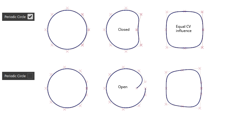

Periodic refers to the difference between open and closed geometry. For example, there are two ways to create a circular shaped curve:
Creating periodic geometry
Circle curves and revolved surfaces have an option to create periodic geometry, which are always 360 degrees.
Sphere, Cylinder, and Cone surface primitives (set to 360 degrees) are always created as periodic geometry in one direction. A Torus is periodic in both U and V.
Periodic geometry is only accurately circular if the Rational Flags are selected in the Construction Options. Periodic geometry is therefore typically used for concept modeling rather than for accurate circular geometry:

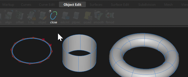

Open/Close
The Open/Close tool opens closed geometry and closes open geometry. The number of CVs is maintained but the spans are reduced creating a change in the shape.
A surface can be periodic in U or V directions, or in both (a torus for example). To select which direction to make a surface open or closed in, select the U or V isoparm.
Detach
The Detach tool can be used to change from periodic to open geometry.
Detach maintains or increases number of spans and so adds CVs to maintain the smoothness at the new end points or edges. This maintains the shape after the detach, unlike the Open/Close tool. Use Ctrl to detach at an edit point or isoparm.

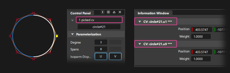

Deep dive: CVs on periodic geometry
Periodic geometry has some CVs that appear to be double CVs in the Information Window, but this is only a technical representation.
In all selection and modeling situations, these are treated as single CVs.
