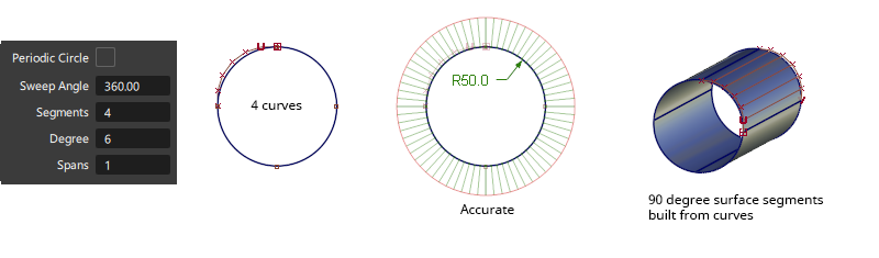

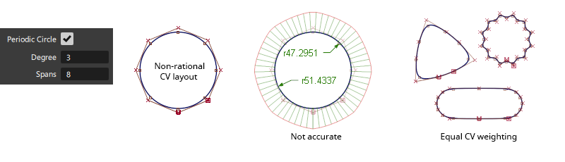

Non-rational geometry
Non-rational geometry constrains all CVs to having the same weight value of 1 (CV weighting is displayed in the Information Window).
This has the advantage that each CV has the same influence over a curve or surface, making it easier to predict its effect on the shape. The only disadvantage of non-rational geometry is that it cannot create circular accuracy for periodic circles and revolves (conics).
Use non-rational geometry for:

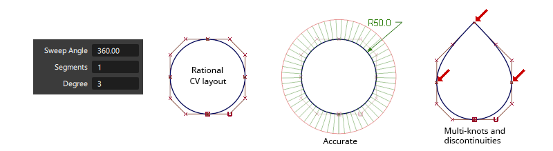

Rational geometry
Rational geometry allows for different weights to be applied to CVs. This allows for accurate circles and revolves but also constrains them to being periodic only.
The geometry is more complex mathematically so modeling with rational geometry may not transfer successfully to downstream CAD packages. It also creates multi-knots, which give poor results or discontinuities when moving CVs.
The CV layout for rational and non-rational circles is different.
Note: the following presets in Construction Options default to rational geometry for curves and surfaces: Pro/ENGINEER, Unigraphics, and Solidworks.

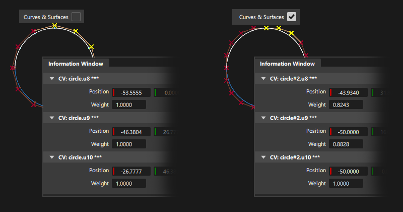

Identifying rational and non-rational geometry
The nature of the geometry can be determined in three ways:
  • The CV layout on rational and non-rational circles is different and is the most common way of identifying rational geometry.
  • Use Query Edit and the right mouse to select the geometry. The nature of the geometry is displayed as the last entry in the information pop-up window.
  • Select CVs and use the Information Window to identify if any weights are not set to 1.
