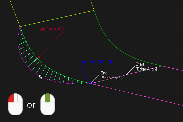

Surface Fillet Tool Additions
You can now use your mouse to control the curvature comb in the Surface Fillet tool. When the Curvature Comb is on, LMB or MMB dragging the comb increases or decreases the comb density. Use the RMB to move the comb along the fillet.
For more information, see Surface Fillet.
