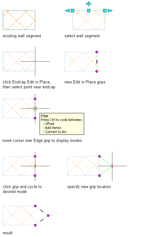

Use this procedure to add a vertex to a wall component edge with Edge grips.
. | If you want to... | Then... |
| Save any changes you made during the edit-in-place session as a new style | click ![]() . |
| Discard any changes you made during the edit-in-place session | click ![]() . |
| Save any changes you made during the edit-in-place session | click ![]() . |
In the following example, a vertex is added to a wall component edge with an Edge grip.
