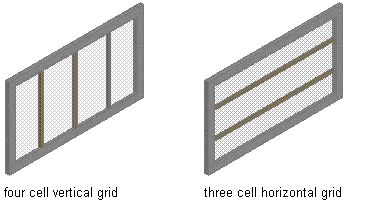

Use this procedure to define a specific number of cells in a grid. In this case, the size of the cells is determined by the length or height of the grid, depending on how the grid is divided.
Specifying a fixed number of cells for Door/Window Assembly grids
Door/Window Assembly Styles.
| If the orientation is… | Then… |
| horizontal | specify an offset distance in Bottom Offset or Top Offset. |
| vertical | specify an offset distance in Start Offset or End Offset. |
