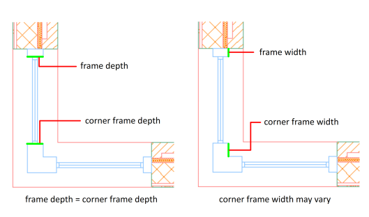

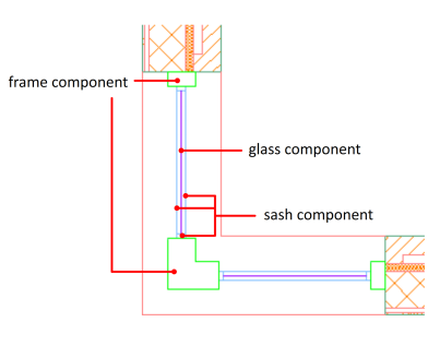

In a corner window, corner window frame is classified into:
The frame component is divided into frame and corner frame.
In a corner window, frame depth and corner frame depth are equal. Frame width and corner frame width may vary. The shorter side of the corner frame is used to determine the corner frame width.
