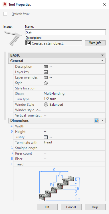

Palette-Based Stair Tools
When creating a tool for a stair style you may want to consider the following optional pre-sets:
- Stair shape: although many properties of a stair can be changed after the stair has been placed, the stair shape can only be set at the time of creation. You may want to consider having the stair shape (multi-landing, U-shaped, spiral or straight) be a default setting for your stair tools.
- Turn type: you can specify either landings or turns. This is also a setting that cannot be changed after the stair has been placed.
- Winder style and winder style location: If you specify a turn as the turn type, you can set the winder style to use on the turn. If you specify the winder style, you can also specify a different drawing from which to import the winder style.
- Stair termination: You can pre-determine whether the stair should end with a riser, tread or landing. This setting can be changed after the stair has been placed as well.
The stair tool properties
