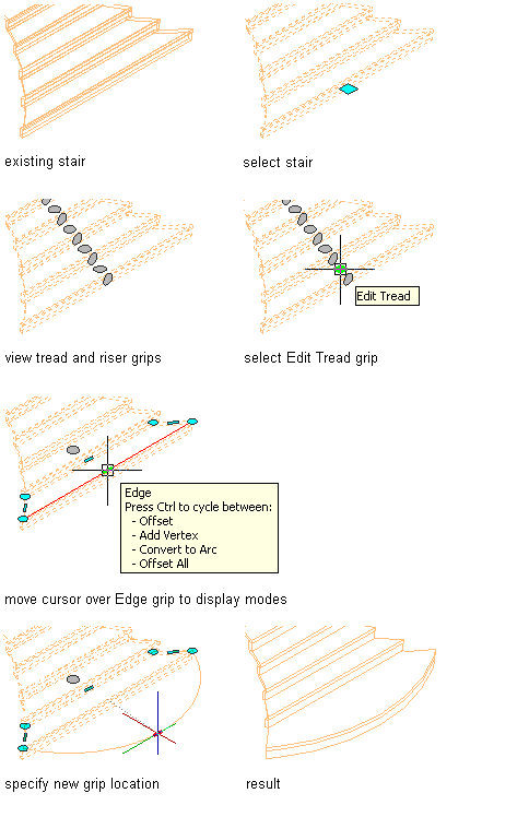

Edit a Custom Stair Tread
Use this procedure to convert the edge of a custom stair tread to an arc.
Select the custom stair that you want to change and click

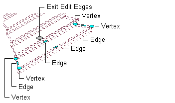

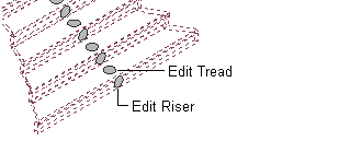

A grip appears at the midpoint of each tread and riser.
You can select either edge or vertex grips to modify the face of the tread. The following grips are displayed for editing the face of a custom stair tread:
A tooltip with the following options is displayed:

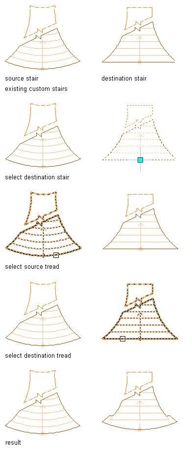

Match Tread/Riser
Use this procedure to modify a custom stair tread by matching an existing tread on another custom stair.
Create 2 custom stairs: one with a source tread to match, and one as the destination custom stair.
. You have the option of matching a tread, a riser, or both.

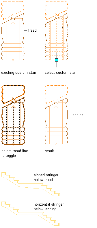

Toggle Tread/Landing
Use this procedure to convert a custom stair tread to a landing, or convert a custom stair landing to a tread.
Select the custom stair that you want to change, and click
. When you use a stair style that has defined stringers, you can see that the stringer is parallel to the landing and sloping for the duration of the tread.

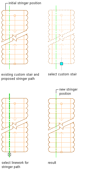

Replace Stringer Path
Use this procedure to replace an existing custom stair stringer path with a new stringer path by selecting linework. The linework must occur within the stair to be valid for selection as a replacement stringer path, and must follow the entire length of the stair.
