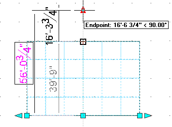

Use this procedure to change the base height of a curtain wall unit. You can also change the base height on the Properties palette.
As you move the grip, the original base height value is displayed in addition to the new base height and the difference between the two values.
After selecting the grip, you can also enter a new value for the base height of the curtain wall unit.
