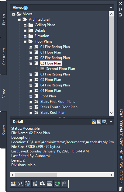

Use this procedure to specify the name, description, category, and template file for a new view drawing.
, and in the Add View dialog box, click the view type (General, Section/Elevation, or Detail).
| If you want to… | Then… |
| name the new view drawing | enter a name. If the project number is used as a prefix for project file names, you do not need to enter the prefix here. The complete name with prefix is displayed under File Name. |
| enter a description for the view drawing | click the value for Description, enter a description of the view, and click OK. |
| change the category of the view drawing | click the value for Category, and select a category from the list. The category you chose in step 3 is recommended. |
| select a different template file | click
