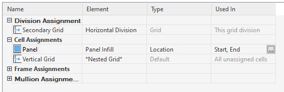

Use this procedure to specify edges that use a frame assignment. When you create a frame assignment, you need to specify the edges of the frame to use that assignment.
Frame edges that are not assigned a frame definition are not displayed.
. Location is the only way to specify the frame edges.
Specifying frame location

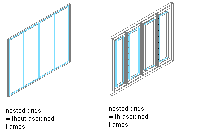

Assigning frames to nested grids
Do not assign multiple definitions to the same frame edge because only the last definition assigned to the edge is used.
