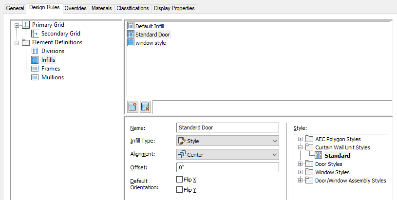

Use this procedure to modify existing elements in a curtain wall style. A curtain wall consists of division, infill, frame and mullion elements, all of which are defined in the design rules of the curtain wall style.
Curtain Wall Styles. The list of element types is displayed.
Element definitions list
| If you want to modify … | Then … |
| a division definition | click Divisions under Element Definitions. In the right pane, select the division definition you want to modify and edit it. |
| an infill definition | click Infills under Element Definitions. In the right pane, select the infill definition you want to modify and edit it. |
| a frame definition | click Frames under Element Definitions. In the right pane, select the frame definition you want to modify and edit it. |
| a mullion definition | click Mullions under Element Definitions. In the right pane, select the mullion definition you want to modify and edit it. |
