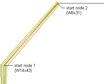

Use this procedure to create the first rafter of the rigid frame by assigning a different start and end shape to the second segment of the rigid frame member.
Creating the first rafter of the rigid frame
- Click Add to add a second component to the structural member.
- Select Unnamed under Component, and enter Rafter 1.
- Under Start Shape, in the Name list, select W14X43.
- Select Start for Relative to.
- Enter 1 for Node.
- Scroll to the end of the Design Rules dialog box to display the End Shape parameters for Rafter 1.
- Under End Shape, in the Name list, select W8X31.
- Enter 2 for Node.
