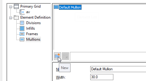

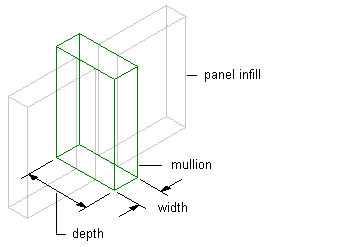

Use this procedure to define mullions by specifying a width and a depth.
Because door/window assemblies can contain multiple nested grids with different mullions, it is helpful to use a naming convention for grid mullions that indicates the grid location or purpose within the door/window assembly. For example, L3-FL1- Window Mullion identifies a mullion for a window in a third-level grid on Floor 1.
Specifying Door/Window Assembly mullion width and depth
Door/Window Assembly Styles.
After you create a mullion definition, you can assign it to any mullion in a door/window assembly.
