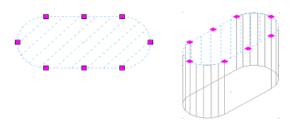

When you enter the edit-in-place mode, a temporary profile is drawn around the object or component being edited.
In-place edit profile of extruded mass element

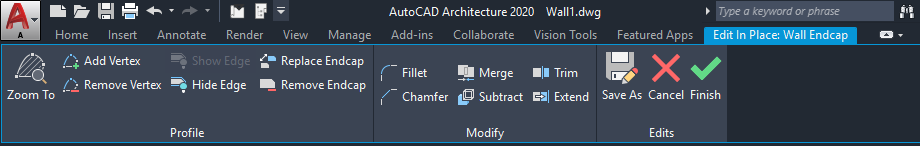

The edit-in-place mode is characterized by the following user interface changes:
Edit in Place tab for Wall Endcaps
