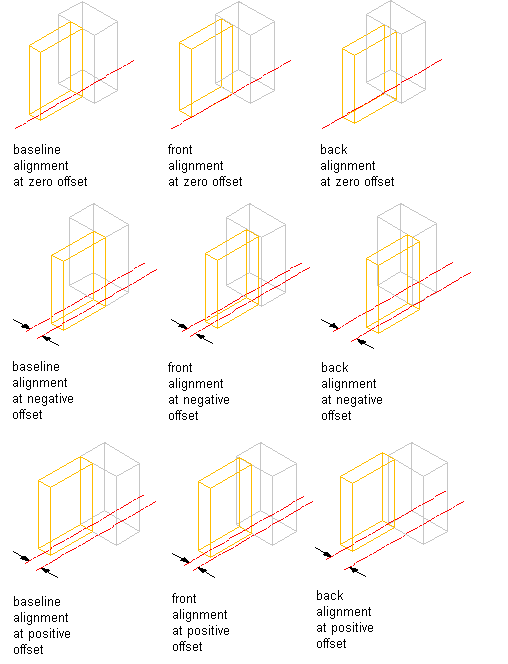

Use this procedure to specify an offset for a door/window assembly infill. By default, infills are centered on the door/window assembly baseline. If your design requires that the infill be aligned with frame edges or some other part of the door/window assembly, you can specify an offset for the infill.
You can also edit individual style-based infills directly in the drawing. The selected infill has Flip grips in both the X and Y directions so that you can change the orientation of the infill.
Specify Door/Window Assembly infill panel offsets
Door/Window Assembly Styles.
. In plan view, positive numbers offset the infill above the baseline and negative numbers offset the infill below the baseline. The offset is also affected by the selected alignment for the infill.
