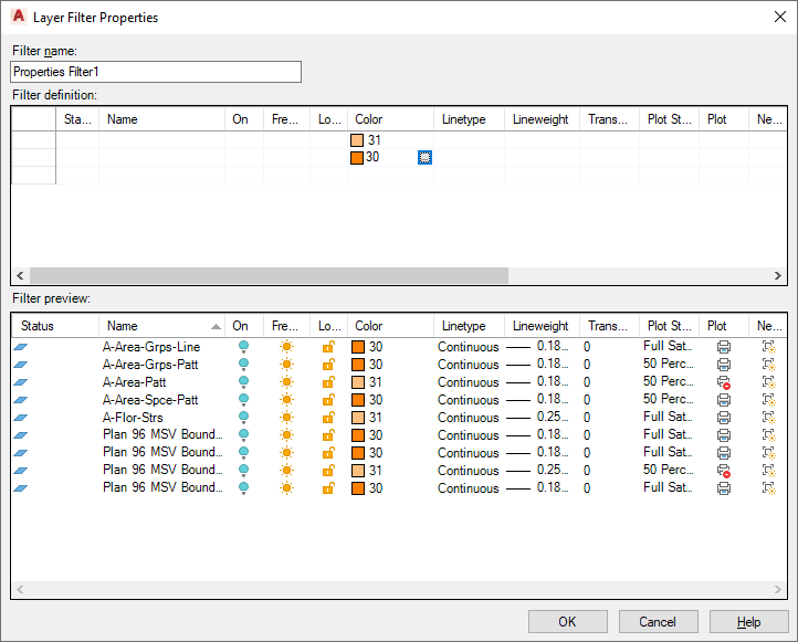

You can also specify more than one set of criteria for a property filter. For example, you can create a filter that will include all frozen red layers and all frozen blue layers. Boolean AND/OR logic is applied to the filter definitions to determine which layers to include. A layer must meet all the criteria in a single row in order to be included in the filter. Continuing with the example, a layer must be frozen and red to be in the filter. Multiple rows offer alternative criteria. In the example below, a layer must be overridden with the color 30 or it must be overridden with the color 31.
Example of a property filter with multiple criteria
