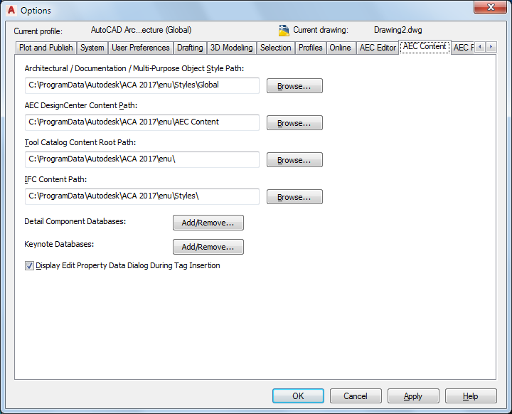

Use this procedure to specify the default AEC Content options for the current drawing.
You can specify the location of the content files accessed by the Custom View in AutoCAD DesignCenter, choose between imperial and metric content, and specify whether the Edit Property Data dialog box is displayed when you insert schedule tags. You can also specify the location of dependent files, such as styles for tools.
Specifying default AEC Content options for the current drawing
When this option is chosen, a worksheet will display after each tag is placed, allowing you to edit property set values. If you clear this option, no worksheet will appear during tagging.
The variable, %AECCONTENT_DIR%, used for tool-dependent file references, is updated to use the path you specify. For example, <Style href=“%AECCONTENT_DIR%Door StylesDoorStyles.dwg”/>.
