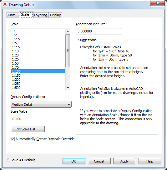

In the Scale tab, you can do the following things:
The annotation scale determines how many drawing units in the drawing represent one inch (for imperial drawings) or one millimeter (for metric drawings) in the plotted drawing. A drawing scale of 1/8”=1’-0” (or 1:96 - eight eighths per inch times 12 inches per foot) in a drawing that has inches as default drawing units means that 8 feet in the drawing are represented by 1 inch on the plotted out plan. Likewise, if a drawing has a scale of 1:200 and a drawing unit of millimeters, then 200 millimeters in the drawing will be represented by one millimeter on the plotted out plan.
Annotation plot size, multiplied by the scale factor, determines the height of plotted annotation text. Scale-dependent objects in a drawing are scaled automatically upon insertion to reflect the units that are specified in a drawing. Any content that you create can be built to take advantage of these settings and is thus scaled appropriately.
Specifying default scale options for the current drawing
Under Scale value, the currently used annotation scale for this display configuration is displayed.
The override applies a scale factor to the dimension style properties.
If you clear Automatically Create Dimscale Override, the software is prevented from automatically applying an override to the current dimension scale style in the drawing.
The annotation plot size is always measured in millimeters for metric drawings and in inches for imperial drawings. Annotation plot size, multiplied by the drawing scale factor, determines the height of plotted annotation text.
| If you want to… | Then… |
| save the scale settings as default settings for new drawings that you start from scratch or from templates that do not contain drawing setup information | select Save as Default. Settings on the Units and Layering tabs are also saved as default settings. |
| save the scale settings only for the current drawing | clear Save as Default, and then click Apply. |
If you also changed the drawing units, you are prompted to specify whether existing objects in the current drawing should be scaled for the new units.
