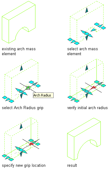

Use this procedure to change the radius of the arch within an Arch mass element using grips.
You can also change the arch radius on the Properties palette.
Editing an Arch mass element with its Arch Radius grip
The radius of the arch changes as you move the grip.
