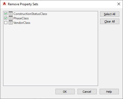

Removing property sets from a classification
If the Remove button is unavailable, you cannot delete the classification because it is currently assigned to an object type.
