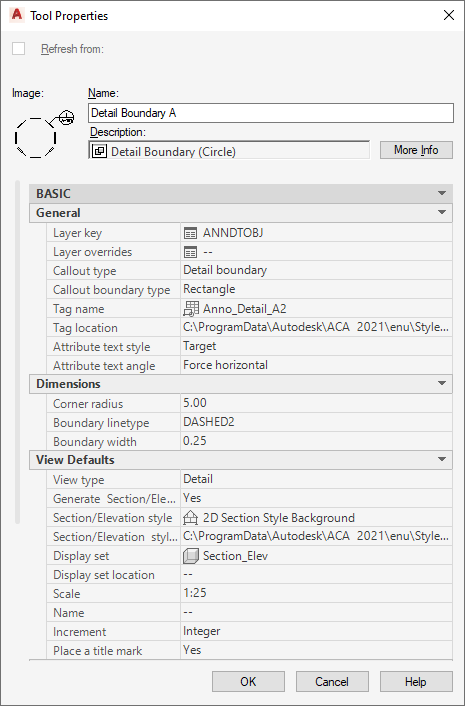

- Section/elevation styles cannot, by themselves, be made into a palette-based tool. Instead you refer to them in a callout tool’s properties. You can specify the library file containing the section/elevation style, and the specific section/elevation style to be used with the callout.
Callout tool properties including the 2D Section/Elevation Style to use, the style library from which to import the style, the default scale and display set to use.
