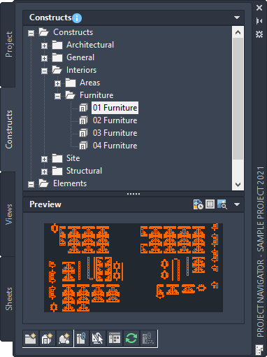

| Use this option… | To display |
| Name | only the name of the drawing file, maximizing the file tree visibility. |
| Preview | only a preview image of the drawing at the size you specify (Small, Medium, or Large). |
| Details | only a text description of the file, identifying its location, size, last-saved date, and last editor. |
| Preview & Details | both a a text description and a preview image at the size you specify (Small, Medium, or Large). |
