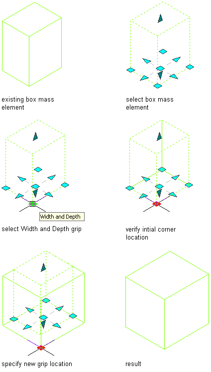

Editing a Box mass element with its corner grip
The location of the opposite corner remains fixed while you move the mass element corner.
If you want to enter a specific value for the second direction in the Width and Depth edit mode, press Tab to cycle to the second direction value.
