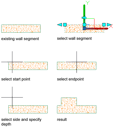

Use this procedure to add a wall modifier of an existing wall modifier style to a wall. You can apply the modifier to one or both sides of the wall or the component. The left and right sides of the wall are determined from the start and endpoints of the wall.
. After you select the first point, a temporary line is displayed to show you the length of the modifier.
Adding a wall plan modifier
