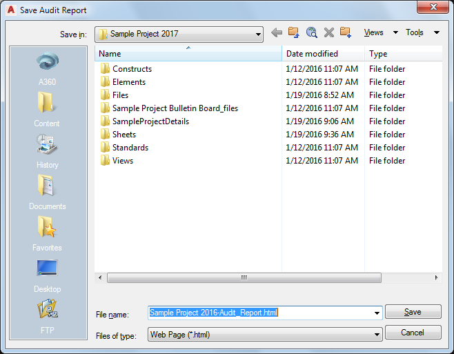

The result of the audit is placed in an HTML or XML audit report.
. When the audit is finished, the Save Project Standards Report dialog box is displayed.
The report is saved as an HTML or XML document in the specified location. You can open it with a Web Browser or an XML editor.
