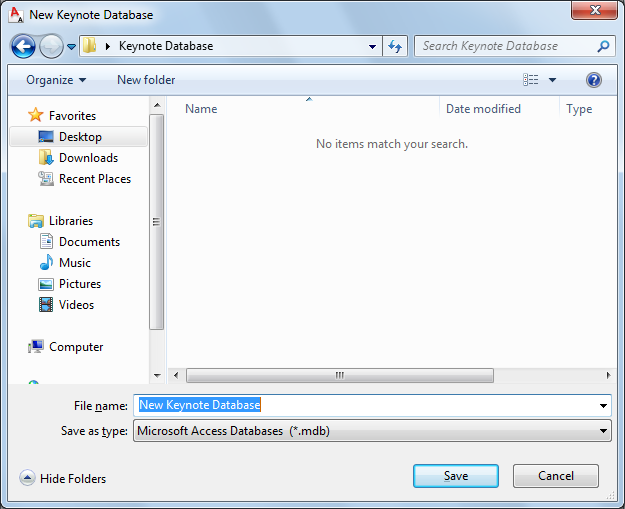

Use this procedure to create a blank Microsoft
Access database with all required tables and queries for keynote storage and retrieval. This is the first step in creating a new keynote database using the Keynote Editor.

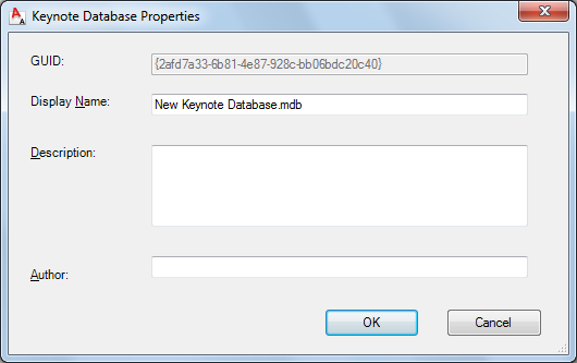

A node named New Keynote Database is displayed in the Keynote Editor.
A blank Microsoft Access database is created with all required tables and queries for keynote storage and retrieval. The new database has the global unique identifier shown in the GUID field and is displayed in the Keynote Editor as a root node with the display name you provided.
You can now begin populating the database by using the Keynote Editor to add groups and individual keynotes.
